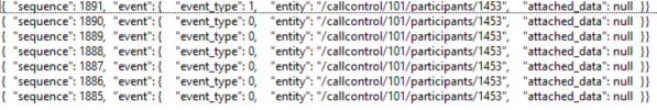

I'm listening to "wss://{{fqdn}}/callcontrol/ws", so far so good.
The flow I'm testing is this...
  1. 101 calls 138
  2. 138 blind transfer call to 139
  3. 139 answers
  4. After some seconds 101 hangs up
Here's the WebSocket events I receive...

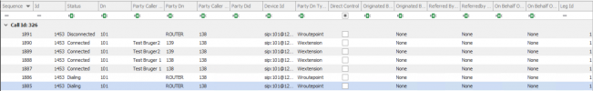

Each time I get an event, I get the participant like "/callcontrol/101/participants/1453", so the flow looks like this:
My biggest problem is, that I don't get a "Disconnected" (event_type 1) when 138 blind transfer call to 139.
Is that a bug?
Also why is "attached_data" always null? Would love if "attached_data" actually contained the participants info.
Thanks.
