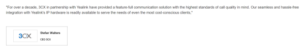

Let me counter clarify as I don't believe you understand the 3CX position on this particular topic.
3CX supports sidecar BLF expansion peripherals. These phone peripherals provisioned via the template for phones.
3CX supports Yealink T3x phones.
3CX announced support of the WH62 headsets.
Are you clarifying that 3CX doesn't intend to support WH62X phone headsets? See below:
Please re-read my original post with the eyes of understanding that I am giving 3CX a fix for something 3CX claimed support of.
It makes no sense for me to contact Yealink, I don't have any support channels, or engineering contacts.
I suppose 3CX can go to Yealink and ask them to change the default parameter for T3 series, QA new firmware, push new firmware globally, wait for 3CX to QA firmware, and wait for a release to include update, then update my phones.
Or, 3CX can do what their template/provisioning system was designed to do. Seriously, this is exactly the thing 3CX templates are meant to be able to handle. There isn't much for 3CX to do other than ctrl-c ctrl-v, pretty up the commenting to be consistent with 3CX formatting. (I intentionally used a comment format that was different), run a syntax parser test on the template (your developers do have a lint rule file for 3CX template language in BNF format, right?). Run a test on a T4 series to see it isn't broken, run a test of T3 series phone to see it isn't broken. Done. Release as a template update, which we get all the time. 3CX doesn't even need to spend the $200 to buy an EHS35 and a WH62 headset,
When we talk about headset integration in 3CX, we mean that this is for the desktop app and webclient (we added an integration so the headset buttons will work with our client).
As mentioned earlier, we do not provide support for headsets on IP Phones and never did before AFAIK. Please contact Yealink about this to get it added if you wish to do so - as a Yealink customer you can request features directly from them, and if they add it into the firmware (which in all likelihood they will) then we will publish it as soon as they update the templates, the firmware files and perform the testing with 3CX as is our usual procedure with all IP phone manufacturers.
I would like to make it abundantly clear that the IP Phone manufacturers are responsible for creating and maintaining the templates and firmware, and carrying out the interop testing with 3CX. We can then later publish it once they've completed their part.
