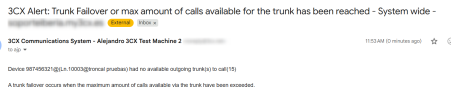

You may enable the alert below
Also in the event log I got this when reaching the max calls in the sip trunk

Yes, yours was different.
In the event log document you may check the event id.
