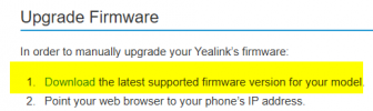

1.Always start here https://www.3cx.com/sip-phones/
2. Read the guide for your phone, and it will have reset and upgrade instructions linked
..and of course the upgrade instructions have a link to firmware page, you can't miss it:

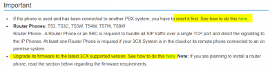

Tips:
  • If the guide says a model is a router, then get the latest 3CX firmware installed and you can then be sure the SBC / router mode is included - no guessing.
  • If your phone (any brand not just Yealink) has firmware that is very old, the manufacturer will prevent it from upgrading to avoid unexpectedly bricking the device. In this case, you need to contact the manufacturer or go through their knowledge base, get the required versions you missed, and upgrade step by step until you reach a ver. close enough to install the 3CX version. This part is out of our scope, and falls within the manufacturer's support scope.
