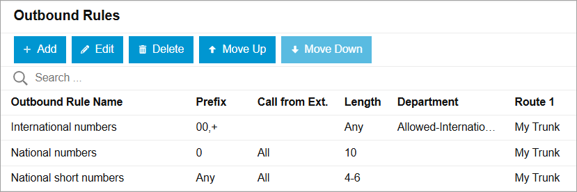

First, you should configure your outbound rules correctly and not have “loose” outbound rules. A good practice is to have separate rules for international numbers and national/local numbers, with the international one being the one to restrict the most.
An international number, as per ITU standards, starts with an exit code such as + or 00 for most countries. Others like the USA have a different one, which is 011. So you can have a rule for those with criteria of prefixes separated by commas: “00,+” and define strictly who can place calls through this rule, either by listing extension numbers separated by commas, or extensions groups.
A local number in many countries starts with 0 or has fixed lengths which can be used as criteria as well.
