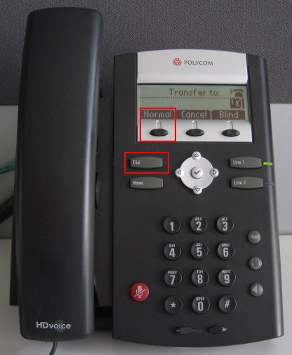

- Press the “Trnsfr” soft key.
- Press the "Blind" soft key and dial the extension number of the person you would like to transfer the call to. Press the "Dial" button to complete the transfer.
Attended Transfer Method
- Press the “Answer” soft key to answer an incoming call.
- Press the “Trnsfr” soft key to start the attended transfer procedure. This will automatically put the caller on hold.
- Press the "Normal" soft key and dial the extension number of the person you would like to transfer the call to. Press the "Dial" button.
