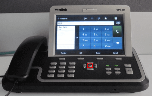

Blind Transfer Method
  • Press "Answer" on the touch screen to answer the call
Yealink VP530 - Blind Transfer
  • Press the "Transfer" button on the touch screen, enter the extension number of the person you would like to transfer the call to. Press "Transfer".
  • The call has been transferred to the specified extension.
