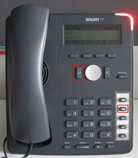

- Make or Answer a call.
- Press the "Line 2" button to make another call. The caller in Line 1 will be put on hold.
- Dial a number and press "OK" (check mark).
- Press the "Cnf.On" soft key to merge the calls from Line 1 and Line 2.
- To end the conference call, while "Conference" is selected on the screen (indicated by a triangle ">" next to it) press "X".
- To talk privately to a participant select him/her using the UP and DOWN arrows and press "OK" (check mark). The other participants will be put on hold. Press the "Cnf.On" soft key to return.
- To place a participant on hold select him/her using the UP and DOWN arrows and press the "Hold" soft key. Press the "Cnf.On" soft key to return the participant to the conference.
- To drop a participant from the conference select him/her using the UP and DOWN arrows and press "X".
