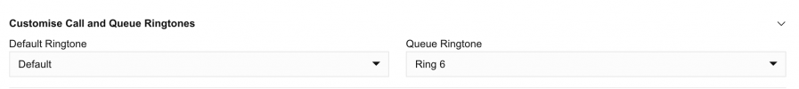

Did you try to use the queue ringtone ?
Paulo
If you try tweaking here:
...in the IP Phone tab of a user, does it help?
Hi Matt,
It looks like specifically Ring 6 has a problem on that model. We have informed Fanvil about it, but in the meantime you can simply change it to any one of the other ringtones and press save on your extension.
Hi John,
That does seem to have solved the issue.
Thanks

The firmware has now been updated and it contains a fixed Ring 6 (which is the default for queues)
