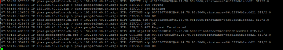

This is what i get... Like I hung up on the caller, but I didnt.

Additional a TCP dump from my firewall:
It seems that it is resolved thanks anyway. The provider had a 30 second forwarding active!
