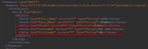

This is your scenario, and you're sending those properties:
I have now removed the lines and uploaded the new template.
Unfortunately the POST message still only contains:
{"data":[{"firstname":"3CX","lastname":"[redacted]","Phone":"[redacted]"}]}
Besides that, the message initially did not seem to contain the keys First_Name and Last_Name, even though those are present as well.
Am I supposed to add something else instead?
Try restarting the services. We've seen some occurrences where the old template seems to be in sort of a cache.
Ensure that you remove the template first, and then upload it again. This way you are sure that it's overridden.
