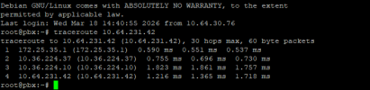

You also appear to have the phone and PBX in different subnets, and PnP messages usually will not be able to cross them. This means that even if you were using supported models, you would still not be able to use PnP.
