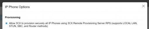

Is this option on or did you maybe turn it off by mistake?

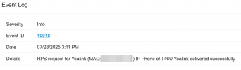

See the Event Log to confirm if delivered
Hi @JohnS_3CX
Ahh, I see that is off, Its working now.
Strange, I can see pbx which we move from v18 to v20 was RPS off, very odd we never touch this option.
Anyway Thank you so much for all your help.

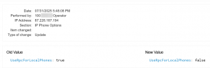

Someone turned it off probably.. If the change was done in V20 it will appear in the Audit Log.
