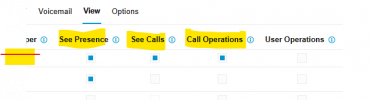

Check what settings they have in the User -> View tab.
Hello James M,
Can you please check on the USERs on the tab "View", and make sure the option "Call Operations" is set for the correct Department.
The Users will need this option for the Call-Pickup (Click on the (i) for information).

Let me try to be more clear.
For the CALL PICKUP to work, you need to 'see' the call, and you need the right for Operation.
So in your OWN department, you need these 3 options set, any of these failing will cause the call pickup not to work.
Example:
USER has role "User" and is in default department 'My Group', and has the rights in this department 'My Group', with options "See Presence" + "See Calls" + "Call Operations".
Can you check if you setup in this way, it does work? or what does happen?

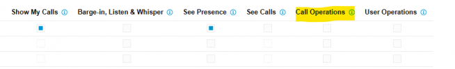

So for us:
If we activate "limit call pickup to department" we cannot use blind pick-up with *20
If we deactivate "limit pickup to department" we can use blind pickup with *20
For me this isn't logically, so I call it a "bug".
(our users don't have the rights "show own calls" and "See other calls")
The system need to know and 'see' the calls to be part of an department, to be able to pickup the call form that department (your own department in this case).
1) The option "Limit call pickups to calls received within the same department" is SET, and the rights for the department are NOT set.
- the call pickup will not work, that makes sence to me.
2) The option "Limit call pickups to calls received within the same department" is SET, and the rights for the department are all set as need be.
- the call pickup will work perfectly.
3) The option "Limit call pickups to calls received within the same department" is NOT set, basically just accept anything do not check any rights.
- the call pickup will work for any call from any department, always.
This all is not a bug for me.
