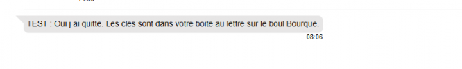

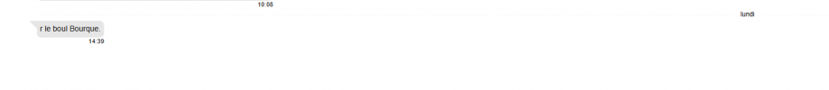

Hi we got a issues with some received chat from voip.ms sms
we received a message and sometimes the message not the same as received in VOIP SMS/MMS Message Center Information
here some images to show the message receive in Voip and what users receive in 3cx.
Is there a way to fix this.

I just tested and if the message is short and with special character it pass but if the messages is a little bit longer the special character i just receive a part of the message in 3cx
The longer message i just receive the end of the message
Please ask Voip.ms if you are hitting the SMS character limit. When using French some of the characters are Unicode so they are occupying more bytes than normal ones.
