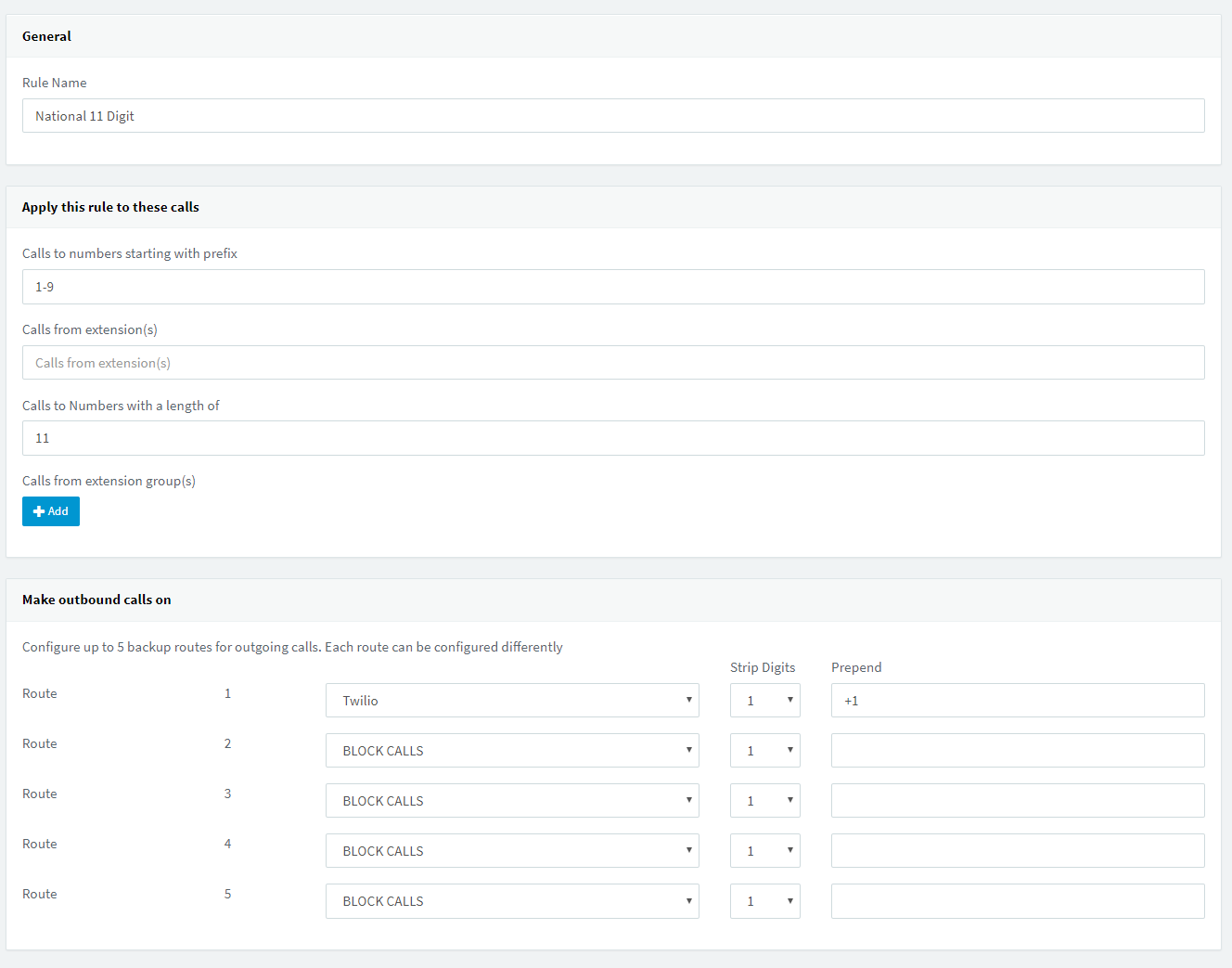

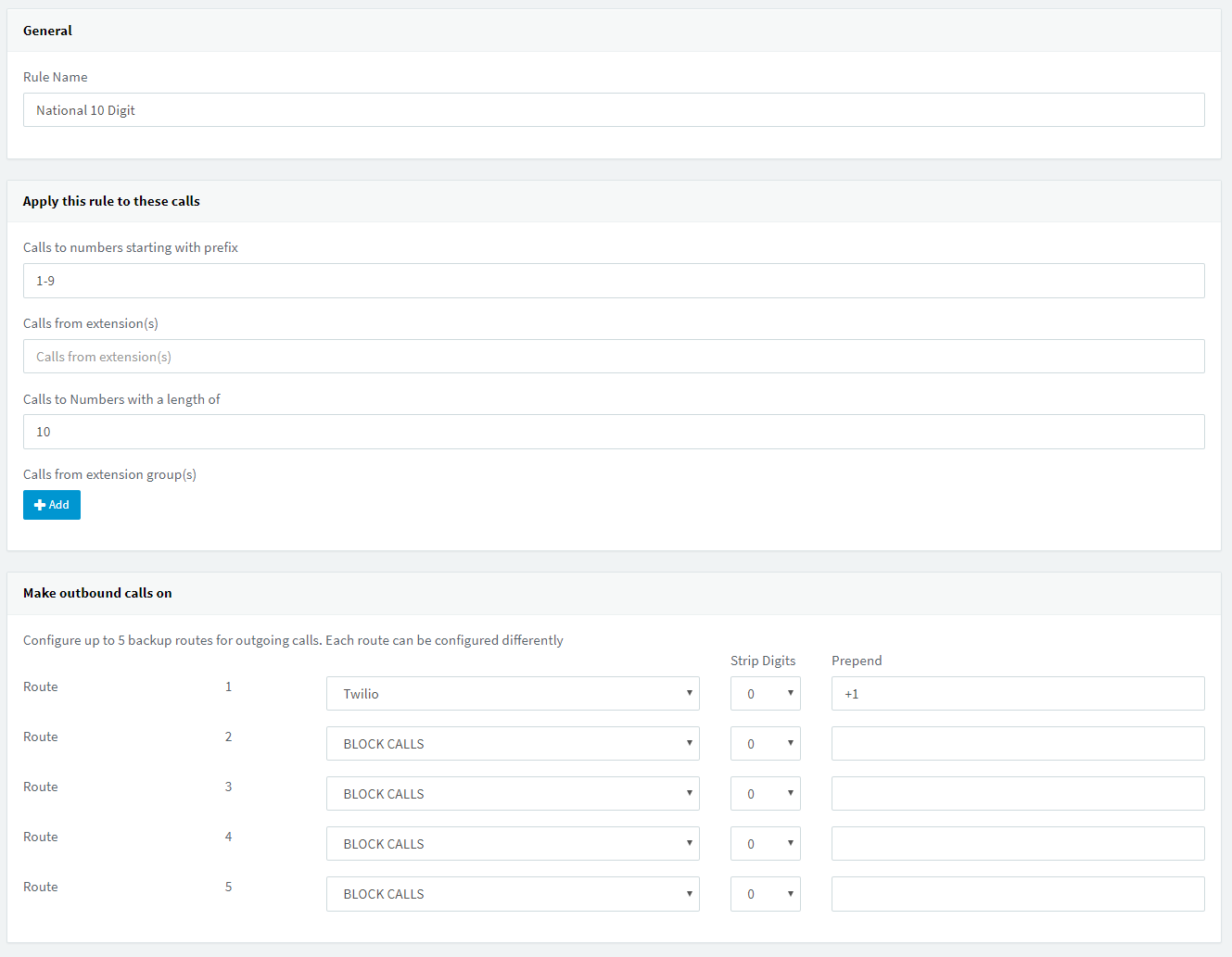

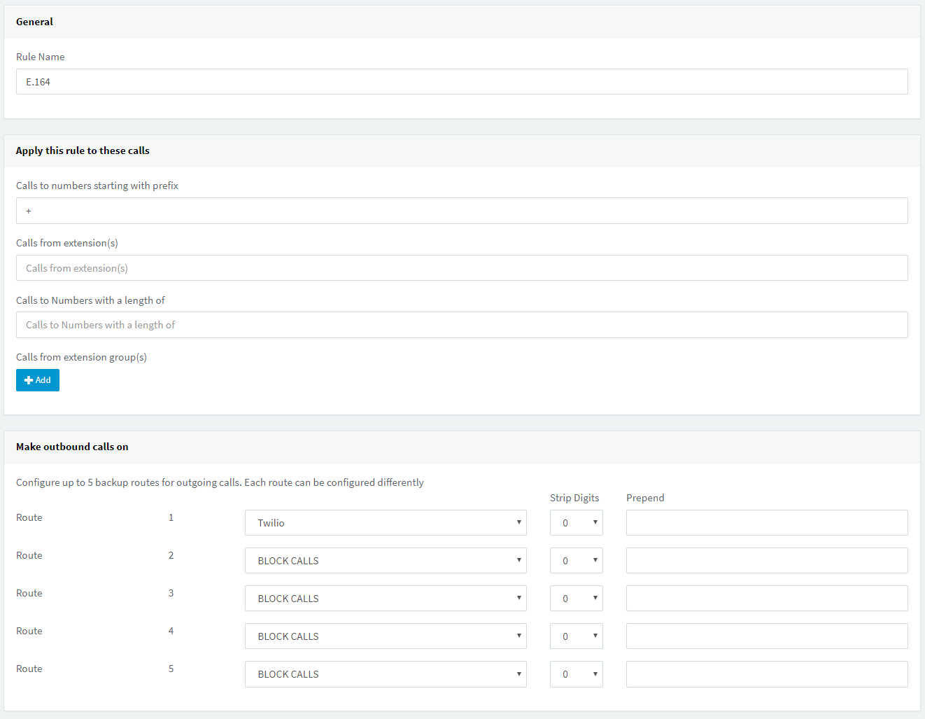

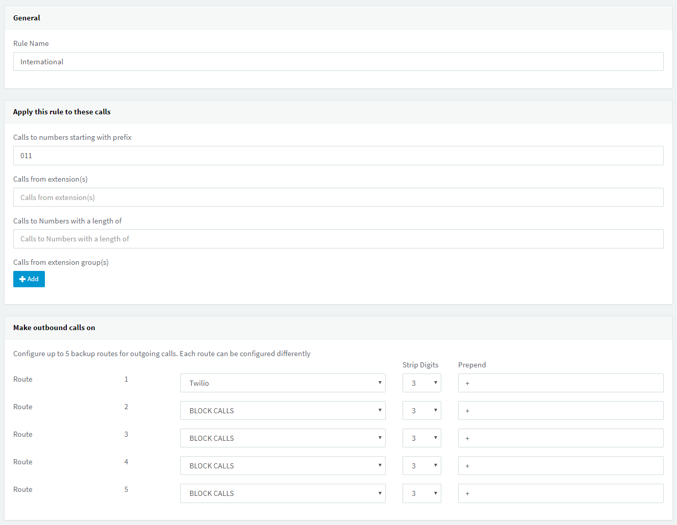

I have confirmed the Origination SIP URI. Here are my outbound rules.
Your outbound rules look correct so the next step is to tun a wireshark capture on the PBX machine and capture an outbound call attempt. This will let you know what the PBX is sending is sending and the providers reply.

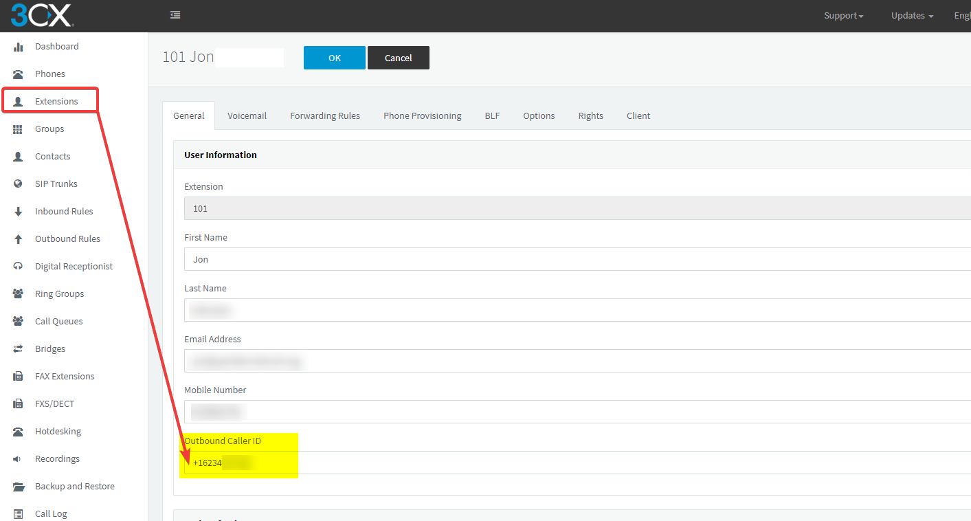

After digging through the Twilio logs it appears you need to set the caller id on the extension to be the phone number digits.
After applying this change is the issue now resolved?
Yes, the change above fixed the issue.
Code:
Outbound Caller ID
For the operation of the trunks, the outbound caller ID of the trunk must be present. This will ensure that a call can still be placed in the event that no outbound caller ID is set for the extension.
Note: Twilio does not support Clip No Screening Calls (sending a number as the Caller ID which is not associated with the trunk). Individual caller IDs per extension shall be set within the extension itself.
