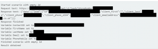

We have a custom integration, with an API developed specfically for looking up into a custom CRM - and the Template file has been uploaded to the Management portal, as well as a test coming back successfully matching the incoming number and returning fields (see screenshots)
But, when this is used for 'real', no requests are sent to the CRM system from the 3CX system; heres our Management Screen and the test result screenshot.

So, during the test, the search result payload does show the ContactURL field being filled in, the Lastname field and the PhoneMobile field
My bigger concern is, I'm testing this with a direct dial number into my extension, but the 3CX system doesn't even make the API call - I'm watching the web server logs where the API is hosted, and no request even hits the server when being used for real.
The template has been uploaded, and the API key has been provided (we're using Basic Auth) and the API works via Postman and via the Test Console, but when a real phone number is dialed into the phone system, its not making the API call out to the CRM system to even bother looking up, let alone disregarding a match if it does get a result.
Edit: I've attached the output of the test (blurred the actual CRM paths, and person details, but you can see the fields are being set)
