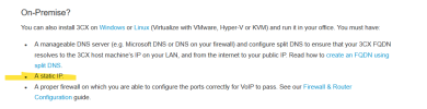

@nisutech summarizing, for a custom domain you have to:
  • Use trusted CA supported by the different endpoints such as browser, OS, deskphones, self-signed are not supported.
  • Use static Public IP in your custom domain, dynamic public IP is not supported for custom domains, that is possible when using the 3CX domains.
  • Custom FQDNs are allowed for Pro and AI subscriptions.
If you plan to use the 3CX Apps in the same pbx LAN, remember to set the split DNS as mentioned in this document.
