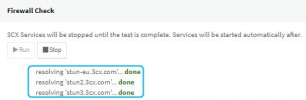

Please refer to my last reply, and do the following:
1. Go to 2Settings >> Network >> Public IP >> External IP Configuration" and correct all stun servers as per above.
2. Apply the settings and go to "Dashboard >> Firewall" and run the firewall checker.
3. Make sure that you see the correct server addresses (the one you set before) at the very beginning of the firewall test:
4. Let me know if the firewall checker passes 100%. (ALL GREEN)

you show 38 minutes ago the 1st STUN is stun-eu.3cx.com is this one located ein EU and stun.3cx.com outside EU region ?
stun-eu.3cx.com is indeed automatically set on eu based PBXs but if you run a dns lookup on both you'll see that stun.3cx.com actually resolves to more ips and it includes the ones of stun-eu too.
Since communication with our stun servers seem ok, try this:
1. Go back to "Settings >> Network" and change the settings to Dynamic IP then click on OK.
2. Go to "Dashboard >> Services" and select all 3CX Services then click on "Restart"
Important: Restarting all 3CX Services will render the PBX temporarily unavailable dropping all active calls.
Let me know if it gets stuck on "Detecting" again.
