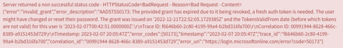

Did 3CX change something on their latest update? For some reason, when i authorize on 3CX, the test succeeds. Then a minute later, I get this error. I even tried creating another app registration but get the same error after a minute. Seems the Token doesn't stick.

Please note that this error message is created from the CRM side. In general the refresh token is stored in the PBX but only the CRM can identify the expiration. When there is an authentication the PBX will sent the token that has stored and the CRM will identify, if it is expired or not in order to send the new refresh.
This error indicates issues issues with your account and not 3CX related.

So with that said, why would i get an expired token from CRM if it's configured as in guideline. It works for a minute and then no longer works. Everything was working fine until the latest updated to 18.0 build 6. So I think there's some bug in 3CX.

Hmm. I started from scratch and same issue. I get this error after a minute after i connect and get it to work. Did you validate that it continues to work after one minute of authorizing?

Oh brain fart! I think i found out issue. After i authorize and test, I click away and forget to click ok to save the new authorize token. *sigh* Sorry to waste your time. It's been a rough week.
