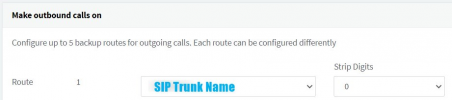

Have you made sure that the new Outbound Rule created has the SIP Trunk configured as the first Route?
@spreaderman
Yes. There is only 1 route and 2 outbound rules. The 2 rules have the same outbound route.
