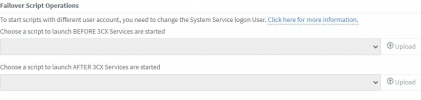

To clarify, regarding the scripts, all that 3CX offers is the ability to launch a script on the Passive server upon a failover event:
That said, how the scripts will be implemented, and what they will do depends entirely up to the administrator. You may find some sample scripts for Windows based machines at the very end of the failover guide, but again, these are merely samples and are in no means the recommended scripts to use.
