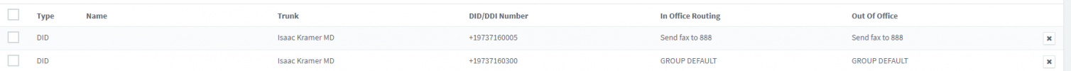

In office the system rings the extensions. Out of office it goes to digital receptionist. There is absolutely no issue with automatic office hour switch. It works as intended. When I try to switch manually it still sends to dedicated out of office digital receptionist. Something’s not right here.
Is there any other inbound rule that when you are In Office will route calls to the IVR?
The rule is there and it is not different for IN or OUT mode. See screenshots.
