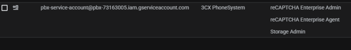

account already has Storage admin right.
