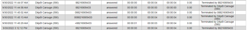

There is the call repport in question
If i dial the same number i get the block prompt message from the 3CX, no metter in witch format (+,00, etc
So based on this it wasn't dialed in international format as it didn't have a leading international dial code (no 00).
Did you dial it in the same way and from same extension? was there no changes to the outbound rules or extension configuration since the incident?
I tried every format possible, and i was blocked in every attempt. if any one as an clue.
