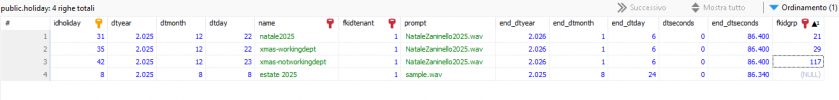

Is there a currently valid holiday entry in both departments?
not working department (was a group in v18)
working department (was also a group in v18)
yep (system time is correct)
I take back the question. I can now see it in the pictures. Yes, it looks like both departments have a valid holiday entry for today.

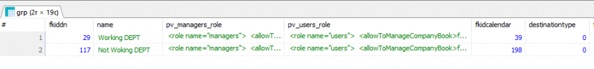

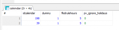

took a look at the db if I could find something different between the two holidays per department and they look the same, but I don't even know if I'm looking at the right tables
Have you, just on the off-chance, deleted and added the holiday back again? Given the time you have been trying to solve this, I would assume yes, but, just in case, asking.
yeah tried multiple times and tried adding multiple single days as holidays. out of 14 departments (all imported from groups), two, including the default one, don't play the prompt
