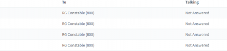

i see incoming calls going to ring group 800 then extension 500
on the ring group I setup Destination if no answer to my mobile
on 500 user I setup forwarding to mobile
it is ringing to ring group 800 , stop and ring again to the same ring group
