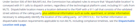

For Ray Baum, it clearly states the answer to your question:
Now generally if you have 24/7 staff onsite who also can get the notification and direct emergency responders to the room that will suffice, but why risk it? I assume you are saving money implementing 3CX. Do you really want to be the person who decides that saving $30/month was more important than perhaps shaving 30 seconds to a couple minutes off the response time in the case of an emergency whether it's required or not?

Thank you for the reply. I guess I should rephrase the question regarding Ray Baum. Is the Ray Baum Act in full effect already for new PBX installations? I know Kari's Law is in effect based on what I've gathered online. So what is the effective date of Ray Baum Act?
Secondly, we are okay with spending the extra money for the DIDs plus e911 service for each room, but it was a general question to see if this cost can reduced/avoided using some other functionality or service.
There are other ways to providing location information, but they are currently more expensive (geared towards large enterprises) and that support is not built into 3CX. So DID is the only method we have now.
The effective date for Ray Baum act is in the link I posted above and yes it is in effect now.
