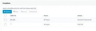

Here's what i did, and it seems to work with the very limited testing I did.
Make a firewall extension for your pager > forwarding rules > exceptions make something like this, changing to your extension range.
112,349
