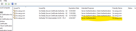

CA changed from godaddy secure certificate authority - g2 to godaddy tls intermediate ca dv - r1v1
I have done this multiple times but I have not run into an issue. i believe the reason I am having an issue is that GoDaddy names. I have updated the SSL certifcates on ubuntu boxes and there is a place to update the CA certificate. Let me know if I need to do anything when the CA authority has changed.

Hi there, it’s the same process. All you need to do is ensure that your certificate that you’re uploading has the full certificate chain that includes the intermediate and root certificates from the CA along with the private key file.
The cert PEM file chain is formatted in this way
-----BEGIN CERTIFICATE-----
The FQDN cert text
-----END CERTIFICATE-----
The CA intermediate cert text
The CA root cert text
You also need to ensure that the certificate PEM files have the correct permissions after you paste the cert PEM and the key PEM files.
