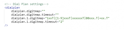

This is the customization I've added to the custom template
And the exported config from the phone has the same settings.
I know this isn't supported, but maybe someone has an idea - I'm pretty sure I missed a simple setting somewhere.

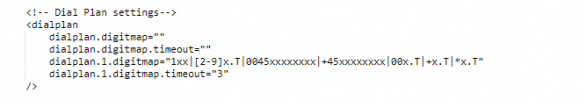

Well, I guess I was a dummy - I was testing it wrong ...
Got it working now, and will present it to the client.
  1. Copied the default provisioning template
  2. Added
    dialplan.1.digitmap="1xx|[2-9]x.T|0045xxxxxxxx|+45xxxxxxxx|00x.T|+x.T|*x.T"
    dialplan.1.digitmap.timeout="3"
  3. Test 1: Reprovision the phone with the new template. All OK.
  4. Test 2: Factory reset the phone and provision with new template. All OK.
The only question that remains is wether to edit the provided provisioning template and then reprovision all phones, or make a copy and delete/add/provision the phones.
By using the default template I risk it being overwritten by an update, but as these are legacy phones, that's pretty unlikely to happen.
Creating a new provisioning template takes quite a bit longer as I need to delete/add 100+ phones *and* they will be red with the custom template warning.
1xx: Dial three digit service numbers starting with 1. No delay
[2-9]x. Dial any regular number number not starting with 1. 3 second delay
0045: Dial Danish numbers. No delay
+45: Dial Danish numbers. No delay
00x.T: Dial any international number. 3 second delay
+x.T: Dial any international number. 3 second delay
*x.T: Dial any number starting with "*". 3 second delay
Only thing missing (and not sure if needed): Dial 4 digit extensions or local calls starting with 1, but if that is needed we just need to add all service numbers (or a suitable pattern).
