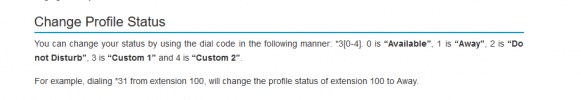

If I dial *32 it says 'out of office status set' (in Dutch) to me. However, it does enable DND.
The DND icon on the phone shows up and the status can be disable/enabled with the dedicated button as well... It also shows as 'do not disturb' in the 3CX clients.
So, it would seem *32 = DND on and *30 = DND off.
If this is indeed the case, then 3CX could/should:
-change the voice prompt that is played back, because it says 'out of office status set' instead of 'do not disturb set'. The 3CX Client calls it 'do not disturb' so that is the right name. I'm using Dutch voice prompts, perhaps the English one says something else
-disable to *60 and *61 completely and remove them from the interface.
Thanks, I will let everyone use the 'new' codes and tell them the voice prompt 'out of office set' actually is the 'do not disturb'
*60 and *61 have been deprecated and removed from 3CX guides for a while now. We do not recommend you use this code nor share it with others.
It still exists in the system for legacy reasons, and it may be completely removed in a later version without prior warning.
