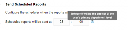

How this works is the following:
You set a specific time under System>>Options>>Scheduler and this time will be used in combination with your main Department timezone.
So for example, you set the Report schedule time to be 23:00 and your department timezone is set to +8:00 Australia (Perth).
The report will be generated at 23:00 Perth time.
However if you schedule the report from an extension whose main department timezone is -5:00 US Eastern time, that report will be generated at 23:00 US Eastern time.

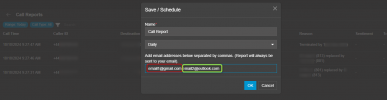

Now in regards to adding multiple emails in the reports, what is added is the ability to add additional emails to receive a specific report when scheduling the report. This looks like the screenshot below.
So whenever this report is generated, an email will be sent to the extension who scheduled it and to the emails specified in the field shown in the screenshot.

Hi @tripo
To clarify, there is no change on when the reports are generated from Update 2 to Update 3.

It will use the timezone of the Department that the extension has its "Main department membership" set to.

You can control the specific time it is set to send.

Each user will have the reports sent at the time stated in their timezone.
So a user with PST will have it sent at 23:00 PST and the users on EST will have it sent to them at 23:00 EST

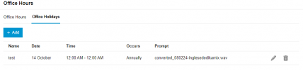

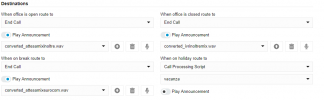

last thing, I tried to set holiday.cs, but it doesn't work correctly, this is my cunfiguration :
if I set the destination to the script does not start the call is closed, instead if I set play message, it is produced correctly.
