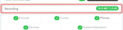

You can check the space you'll save from the Dashboard:
Voicemails are unfortunately not able to move partitions and be read from another location.
