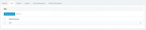

I have a problem with configuration of my GSM gateway. 3CX (ver. 18 up. 2) is installed on win10 computer and its working fine. 3CX server and gateway is on the same LAN (no subnets, NATs and so on) with static IP. My GSM Gateway is 2N Voice Blue Light. Outgoing calls are working like charms - no issues there. Device is configured as Generic SIP Trunk, with authentication thru ip.
Problem is with incoming calls. Of course I configured inbound rules. If I set on my gateway to play a message and receive DTMF, when i put DTMF of my user ext. nothing happens. I have no records of incoming calls in call log on 3cx.
Obvious conclusion is that my gsm gateway is not communicating with 3cx when there is inbound call. I check all setting in gateway many times. My suspicion is something with authorization or some settings in inbound parameters. I place in attachment a quick gateway installation guide.
Please help :(

I place in attachment screenshots of my configuration both in 3CX and in the gateway. For my understanding i should set my gateway to receive mode to accept incoming calls + dialtone, and timeout for entering DTMF digits as 0.

I'm also not certain why you have the DID involved. at this point anyway. DID information, to route calls in 3CX, would have to be sent by the gateway, either a default number, or one you have put in. It is useful in a multi port gateway as a way to identify which, of several trunks, the call came in on. If you are using a single trunk, then a DID is unnecessary. You simply tell the trunk where to send calls, in the inbound trunk settings.

What i should set in Virtual Extension Number: my DID/DDI nr, extension number of default call group/telephone (i try both but i want to be sure)?
I'm going to assume that that is for your DID number. In reality it can be any number, as long as it matches the DID rule you create in 3CX, if that is the way you are routing incoming calls. And again, this is only useful if you have multiple SIM calls, all coming in over one trunk. If you have one SIM per trunk, then it is not important as you would not need DID rules to route the calls.

Ok problem solved - there is a parameter "List of called numbers" - there i need to place a nr for my DDI. Thank you for help :):):) Maybe someone will have same problems as I was so i place a configuration file in attachment (need to change ext from txt to ini). thnx again :)
