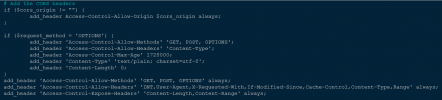

We also manually enabled CORS through the Nginx of the 3CX PBX server; it bypassed the CORS check.
The following rules were added to the location /Myphone
The result has changed from CORS to 404

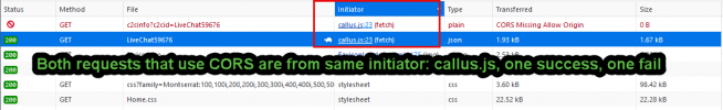

I suspect it's because /MyPhone/c2cinfo?c2cid=LiveChatxxxx returns a 500 server internal error because another CORS request actually succeeded.
The error is disguised as a CORS error because, with 500, nothing has been returned; thus, there is no CORS header.
Nginx config shows that all URL under /MyPhone/.. was handled by proxy (if not a local file, which is valid for the above cases)
Are there any error logs that we can inspect for the @proxy block? http://mc seems to be the shorthand for the management console
After tracing the log I found exceptions of 3CX management console: It logged when processing c2cInfo.
