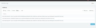

Post the 3CX Activity Log (Verbose) of a failed call, that is supposed to route to the gateway. Post only that call, from the point 3CX receives an Invite from the set, to the point it attempts to pass the call onto the gateway.

Hello, I have uploaded the log records you requested.

It looks as if the gateway is not registering, or 3CX is not sending the outgoing call to the correct IP and port, which is a functon of the trunk setttings in both the gateway and 3CX. To send calls out on the 3102 as first choice, means re-arranging the order of the trunks in the outbound rules.

Yes, it looks like that. The calls are going to the spa and than stops with 404
