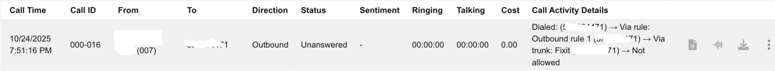

I registered 2 trunk successfully, but I have issues on outbound.
Outbound 1 - Dept 1 (Members 100-109)
Outbound 2 - Dept 2 (110-115)
before adding of Out 2, Out 1 was calling out successfully. after adding out 2 was not calling but 1 yes. now without any change, dept 1 (also other relevant ext's) won't make call but 2 yes.
so I am so confused what goes wrong? btw call is incoming on both dept.

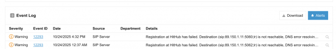

Please make a call, screenshot and send me the Dashboard Event Log directly after the call.
I turned on verbose and now I have, sometimes it failing on Hithub, sometimes fixit.
I am so confused.
I am so confused.
Talk to your SIP providers - your credentials, your IP or something else is off - Most probably wrong credentials for HitHub and maybe when you dial out from Fixit with the HitHub number, that gets rejected by them.
so are you confirming that 3CX configuration is all good and problem is between 3CX and ISP, right?
All we can see is that the SIP Trunk provider is rejecting certain calls. The simplest way to know why is to ask them.
