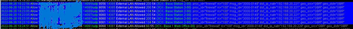

However, Base 2 (Far Office) now has no speech and when I dial any of those extensions I cannot hear the ring noise and when they try and call out they get the same. I can see no RTP passing through the Firewall when I do a call to the phone, but when they do a call to the remote end I can see RTP packets.

Local Firewall Logs: - only shows base 2 log when making a call from DECT, not showing when calling DECT from Remote Source

Yes, that is what is configured too. You can see in the Firewall log that the traffic is being accepted

No, it is not working but you can see traffic flowing from Base 2 when they do a test call but it still doesn't work; however when I call via DID no traffic hits the remote side.
