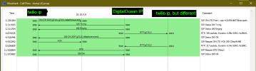

I found a thread where they mentioned the SIP provider might be blacklisted, but I couldn't see anything like that on our system. I got this from wireshark. Can someone troubleshoot from this?
Voice packets are going to be using the 90XX ports as shown in your posts. However it seems that there is some port substitution going on. Port 9012 becomes 50790, and port 9010 becomes 21790, and vice versa. So... there may be something in your firewall that need correcting. There is a list of ports (UDP) used for voice, that was provided in a link, earlier. You need to confirm that these are open on your firewall.

All the ports are open as per the required configuration. It was set up with pbxexpress on DO. The firewall checker passes fine. As a comparison, I tried a call through one of our Twilio numbers and it worked fine. Here is what that call looked like:
If the issue is with the SIP Provider then I will reach out. But I'd like to know that it's not some config issue I caused first.
