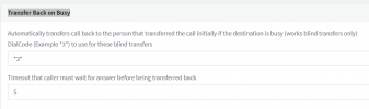

I have the Transfer Back on Busy option enabled as follows:
We are experiencing that some calls revert to the Operator,
