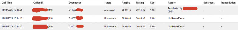

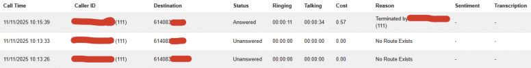

Got another odd one (for me at least). One of our clients is having intermittent issues on outbound calls.
Sometimes when calling out they hear "beep beep beep" and the log shows No Route Exists but they try again and it works.
The issue started yesterday (10/11/25).
Here's two examples:
