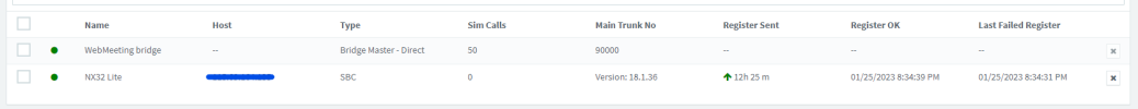

Trying hosted here for the first time, essentially testing before we make it part of our product catalogue. Have previously been hosting in our private cloud without issues but have hit a roadblock using this.
Am currently running a trial of 3CX hosted dedicated standard 4sc on v18 update 6.
3CX hosted by 3CX
I have an NX32 Lite from Call4Tel in place as an SBC which is connected to the 3CX instance successfully
I'm testing with a Yealink T21P-E2 firmware 52.84.0.140 and a Grandstream GSC3510 firmware 1.0.1.3.
Provisioning via SBC.
Phones and SBC on a dedicated VLAN.
Firewall Checker has passed.
No Custom Templates in use.
Issue: Both phones show up on the 3CX phones tab as via SBC. When going to assign extension, I select the extension and options etc and click ok but nothing happens. Have been able to provision no issue via stun but as soon as the option is back via SBC and phone is reset, no dice. Have tried adding the provisioning link in the server URL field and no change.
Checked the 3CX server logs and noticed this line in the log: 2023/01/25 20:39:09.416|21202|0009|Inf|[ManagementConsoleJS.Helpers.CmmLogger] Cannot find template for device MAC=805EC031****, template=yealinkT4x.ph.xml, user agent 3CX WebRTC proxy
Ran a tracert to the ip of the instance and doesn't make it to the end point either via the phone or my laptop. Does get well out of my network though which is interesting.

Case closed. Issue was the Call4Tel device has 2 nics (WAN and LAN) though we only use the WAN but due to having an IP set in the LAN interface despite not being physically plugged in, it was trying to route traffic through to it. Resolved by removing the static IP.
