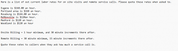

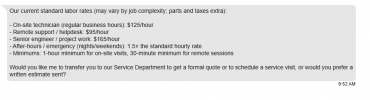

Thank you for that video. I am following your procedure verbatim and I am still receiving incorrect results.
Here is a screen shot of what was uploaded to the knowledge source and here is the chat with the "made up" rates. What could be the cause of this? When I ask the AI where it is getting this information it tell me it is coming from the knowledge source.
Here is the current models being used.
Thank you for the information you have provided so far. What are the next steps to resolve this issue?
Jim
I wouldn't mention the rates in the company description, that is at a higher level - leave it to the description of that knowledge source only.
