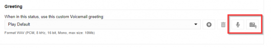

I'm testing a v20 on prem pbx (upgraded from v18) and I don't see a record option for the prompt in the digital receptionist settings. The documentation shows a record button next to the prompt selection box, but my install doesn't have that option.
Image from docs:
My install:
Does anyone else see this?
Thanks,
Same issue, our customers do not manage their 3CX system typically. You can record using the web client if you have a microphone and/or headset, but many of our customers do not use the web client, or the person that we interact with does not. So the solution we came up with is to enable the voicemail on the admin console that you are now using on V20 for admin and have the forwarding on that X set to fwd to voicemail if unregistered or no answer. Have the person who would normally do the recording call that X and leave the new greeting as a voicemail. Then we used the admin web client to upload the voicemail. Then run that .wav file through the 3CX wav convertor at https://www.3cx.com/docs/converting-wav.file. Then you can upload the file using the admin web client. Not sure that this is the "approved" method with 3CX TS but it worked for us.

I noticed this in v18. I am sad that the option to record the prompts from the IP phone is gone. It does make it difficult for receptionists to update their prompts unless they have a really good headset already linked to their computer.
When you want to record the prompts for the digital receptionist, this is not possible.
However on the user greetings the option still exists.
@3CX team: could you please bring the same option back to the digital receptionist? :)

Record via desk phone is available in V20 for setting up voicemail greetings from the admin. So it look likes that the tech is in place.
