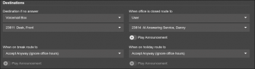

I have a client with an SMB instance that is seeing issues with their call handling rule forwarding properly, I notice that unlike our other customers with a proper license we are not able to verify the system time via any of the diagnostic tools usually displayed within the dashboard. Our department is set for Eastern Time however sometimes the Ring Group forwards to the "when office is closed" destination when they are supposed to be open. For example our office hours on the department which our Ring Group is in is 7AM - 9PM, 7 days a week, after opening at 7AM they still forward to the closed destination. If any one can provide any insight as to what I might be doing wrong I'd love to hear it.

Yes I've confirmed there's no forwarding or custom schedule settings causing the forwarding.
What's weird is the customer used to just accept calls 24/7 but once they called us to setup hours and forwarding to an outside agency we started seeing this issue. It worked for almost a week straight before they had issues over the weekend and I haven't been able to pinpoint the problem since.

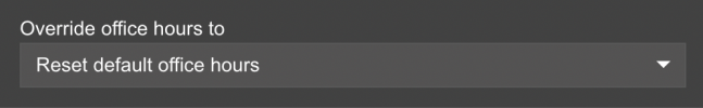

  1. Have the manager/reception login and "override office hours" again and do as below. Someone else may have overridden them over the weekend you mentioned when the issue started, for an unknown amount of time. Unfortunately there is no audit trail in the event log or anywhere I've seen that would alert someone of such a change. Test and see. Screen Shot 2026-03-09 at 11.51.32 PM.png

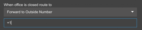

  4. Is there a reason you're having an extension 23814 forward to Vox? Instead of using "Forward to Outside Number". I still really think there's something wrong with those rules that's causing the issue:

  1. Have the manager/reception login and "override office hours" again and do as below. Someone else may have overridden them over the weekend you mentioned when the issue started, for an unknown amount of time. Unfortunately there is no audit trail in the event log or anywhere I've seen that would alert someone of such a change. Test and see. View attachment 51180

Thanks for your help, I've reset the office hours and changed my forwarding after hours to go directly to the outside number in E164 format, I don't remember the exact reason we did it this way prior but I think the previous outbound rules might've interfered with the original callerID passing through, I just tested and this appears to be working properly.
