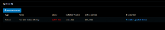

I have a problem in updating our on premise 3CX box, it's currently on version 16.0.5.611 and can't update to version 16.0.5.619.
Every time I try to update it, as soon as I confirm the update, it logs me out of the 3CX console.
I tried this command after connecting with SSH.
wget -O - https://downloads.3cx.com/downloads/misc/debianpatches/9/16/0/5/20200619-os-update.sh | bash
It installed fine and tell me:
Update completed. You may update 3CX from the Management Console or enable 3CX Instance Management.
But when I try to update it from the console, the same thing happens.
Any help with be greatly appreciated.update on the console.PNGupdate with SSH.PNG
The immediate log-out is normal. It actually says so on the popup, as I recall. Then the update runs in the background. Does your server email you the log of the failed install? It should...
