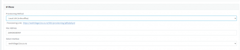

So the phone is provisioned as STUN?
This is how I currently have it
I changed to direct stun, and thats fixed the provisioning on the T54W. I can make calls, and receive them, but there is no sound. Dial tone is fine
The phone is on the same local network as the PBX?
If it is on the same local network you need to use the local provisioning.
Since the interface is the FQDN you also need the split DNS in order to be able and resolve the FQDN locally.
For more information also check here.
I assumed that because I could browse https://rawhitilegal.3cx.co.nz:5001 (while connected via eithernet on the local lan) I had set it up correctly. I've now just changed from stun back to Local Lan (exactly how it is in the screenshot) and the deskphone is now perfectly working. Sound included.
I removed a policy in the firewall though to be fair. It was one for SIP traffic but I had a sneaky suspicion it might have been the issue all along -_-
still unable to sort the handsets. Register failed. Its 5pm this side of the world. Will revist next week. Thanks for the quick support and posts Theo.
