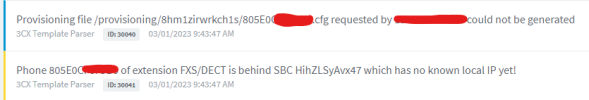

Firstly, the new RPS provisioning is incredible. How that works so quickly blows my mind.
But I just have a little weird thing with router phones not showing online. The handset has registered, and shows in the phone tab as 'via SBC':
But then over in the trunks area, the SBC shows as down:
I wondered if its just the management console UI not updating due to the changes with the WebClient. But it seems to affect provisioning. When I try and generate a file for a DECT base unit that should use this SBC, we get:
I've checked the phone is all on the latest firmware. And confirmed its a X4U-V2 unit. Tried some reboots and things too, and nothing seems to fix it. What am I missing?

Check out this thread: https://www.3cx.com/community/threa...-register-via-router-phone.119233/post-555040
Thanks for the reply. In my situation, this was a brand new phone, never provisioned before. But I got it working by just simply factory resetting and letting it auto-provision again. My suspicion is it needs that latest firmware update to actually provision the SBC side.
So my workflow for now is:
- Add MAC as router phone
- Let the brand new phone auto-provision out of the box
- Push the new firmware from the management console
- Factory reset the phone, and let it restart
Really doesn't take that much longer as the provisioning is so dam fast. And much easier pushing firmware from 3CX than manually logging in to a bunch of phones to upload the firmware directly.

Hi Sam,
Your suspicion was correct but the above workflow won't work because the phone will not have the router-enabled firmware out of the box. It will try to register Direct SIP style because it is missing the SBC part, and get blacklisted.
I will recommend this workflow instead and it should be followed in this specific order:
1. Manually upgrade the router phone firmware - before you ever connect it to 3CX.
2. Set it up in 3CX as a router phone.
3. Factory reset it so it can provision correctly.
4. After the phone comes up, you can finally proceed to add the "normal" phones too.
Thanks for the reply. The steps in my post did work just fine though. The phone came online and I could push the firmware from the management console.
Not sure how your test was done but regardless, the phones will get blacklisted for most people using the default 3CX security settings if they don't follow this order. I think we might revise the guides to make this more clear.
Interesting! The screenshots in my original post show the phone online in the 'Phones' tab, which is obviously where I could push firmware from. And it never got blacklisted.
For what its worth, security settings are the defaults that come out of the box of a fresh install from the deployment wizard.
