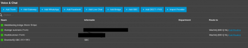

Thanks for you reply Dimitri. The department admin is added to the default group, this customer doesn't have any extra departments, but it looks like the SBC is not in any group, or is it system-wide? If I reinstall the SBC, could I then add it to a department?
edit: I just checked, adding another SBC doesn't give me the option to assign it to a department.

You cannot directly assign a department to an SBC/Router Phone.
If you add an SBC with a user that is a department admin to Department A ( for example ), then the SBC will be part of Department A.
If you create an SBC with system-wide roles ( System Owner or System Administrator ) then the SBC will be system-wide.

That explains it, thank you! Then if I understand correctly, system-wide doesn't mean that it's available in the default department? Because otherwise the department admin in the default department would see the SBC? Please correct me if i'm wrong.
That is correct.
System-wide means that only the roles that have system-wide access can see them.
